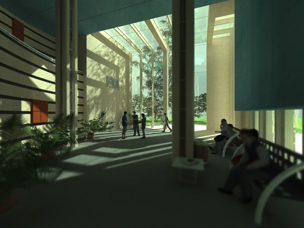

2) Artlantis ..or LW :
It's not the right question. At Abvent, we pay attention to the Architects need and the right tools to achieve it.
Remember that since more than 15 years, we sell ArchiCAD and Artlantis we also sell Artlantis to Vectors works users who have LW since a long time. (be carrefull LW raytrace is not LW radiosity it's very different technology to implment in a software.. .we experiment it last year in Artlatnis, but I cannot speak about that)
As ArchiCAD distributor, we are very happy that the new rendering basic level of ArchiCad is at the same level as competitors.
BTW , this will increase the rendering market around ArchiCAD and the Artlantis R market of course.
There is objectives reason to use internal render and other objective reasons to use an external tool.
Artlantis R is one of the candidate, of course we hope that its new features make it the most popular rendering companion for ArchiCAD, despite the ease of use, the new technology and inovator productivity feature, there is also technical and economical reasons to use external tool, just few arguments
- For large file , manipulation in CAD software become difficult, you get memory limitation etc...
- With external software, you can use a second computer to render and continue to work with your main CAD on the other one.
- Radiosity on one click is really new step in seeting the scene.
(see the attached picture..setting 15 minutes 😉
no way without radiosity
