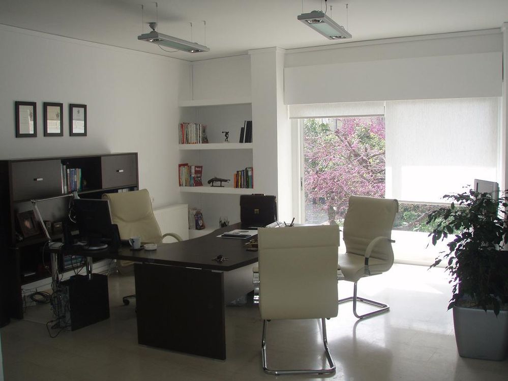

I work archicad 10 and lightworks for rendering after reading users opinions and of course seen the results of your renderings with cinema 4d maxwell and art.lantis tried to change rendering engine...Maxwell and cinema 4d was really hard for me to learn and the results were just funny.Used once in the past art.lantis but didn't have the time to play enough with it.Now its my first serious attempt and its my office.Tried to make it close to the real one.Be honest I'm quite happy with it but i need your opinion and suggestions.I attach the rendering and the real picture! PS. I added the window background with photoshop cause the result with the image as a stretched image background was blurry and absolutely disappointing...excuse my english and thanks in advance!
12 REPLIES 12
There is the new render based on what you ve mentioned.Put some reflection to the glass on the window and reflection on the floor.Looks much better you were right.My problem is that i cant change the objects from artlantis because the archicad model works like one object.So i need to save in archicad a new artlantis file changing the pc screen books etch and the position of the chair that is wrong and disturbs me because a part of the leg is in the desk.Sounds easy but if i will do so i will lose all athe lighting and material settings that took me hours to adjust right. Any sugestions?Whta do you think about the new renedring?
And somethimg else that i always forget to ask.The bowl next to the TV behind the plant is not smooth and looks unreal.Happens to a lot of objects from archicad to artlantis.How do you fix that?
