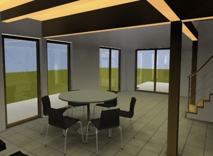

Hi everyone.
My windows inside frames (pine material) are too dark.
Background image (cloudy sky) and grass texture are not visible thru the windows. What should I do?
My light settings for this shot were:
Light Sources
150% Ambient (color - light mauve), and Lamps
LW Sun
Color Yellowish, Intensity 80, Light Source 10, Dever. Angle 2 deg.
LW SkyObj.
Color Light Blue, Intensity 60, Lat. 3, Long. 10,
Undersun
Color Yellowish, Intensity 30, Light Source 15
General Light
Positioned behind of the camera, Intensity 40, Color Yellowish, Distance Fall. 1.00, Height 3'
Window Lights up to ceiling
Color Yellowish, Intensity 70, Light Res. 2, Shadow Quality 3 ,Height 3'
Window Lights from ceiling to floor
Color Yellowish, Intensity 70, Light Res. 2, Shadow Quality 2, Height 3'5''
Thanx, chipo

Thanx for replay & tips, tigr.
I have done everything you told to, but the result is not so good.I have even increased ambient light to 60%, but the shot is still very dark and there are no shadows on the floor. Are maybe my sun setting wrong?
Chipo
My sun settings,
Chipo

This setting aren't good so I changed glass material to one of lightworks glass material.
Here is the reasult and is still no good.

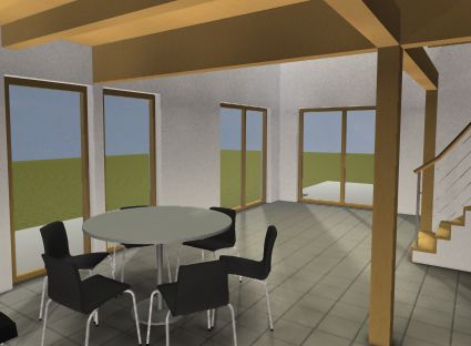

I liked your first lighting best. It was dramatic.
But as to the grass texture and background photo not working:
1: Background: Have you used the LightWorks dialog to set the background? You can also check a box to "Render Background with Internal Engine" as a shortcut.
2: Grass Texture: Have you transferred the texture to the LightWorks material? A texture created in the internal dialog does not necessarily work in LightWorks unless the "Match Internal…" button is clicked. Make a close-up view of the grass to check because it is far away in the view you show.

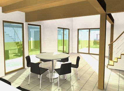

Hi again,
Sorry I didn't respond so long, had to finish some work.
I set up quick scene and try it with the tips I gave you. Results below.
What I used was:
- built-in sun (only for sun burns on the floor)
- sun object (for strong sunlight)
- sky object (shadows off, for warm fill light)
- 7pairs of lightcone down and up, one over another (I found this solution the best/fastest for interiors modeling light)
..and you were right about the glass, I pick the wrong one. I will post some screen shots, too much of typing.
TIP: To avoid square horizont place your model on the big round slab - it will fake infinitive horizont nicely.
...these settings are NOT optimal, just what I used for this particular scene. Hope this helps.
