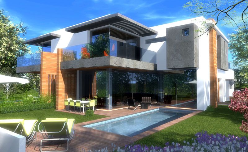

Hi everyone and thanx for your suggestions.
I was surfing the web to reach a conclusion about the best software for my needs but this looks really complicated!
I'm pretty sure Archicad is the most complete solution to create the model.
I will use Sketchup just to save the sketches.
For the rendering solution to combine with Archicad i'm still undecided between Artlantis, 3Ds+Vray and Cinema 4D+Vray.
I was pretty sure to choose Archicad+ 4D Cinema Architecture Edition +Vray but studying the products in internet new doubts came out:
1) What does 4D Cinema offer more than 3D Max?(I love the Sketch and Toon module)
2) I was sure Artlantis wasn't enough but I found some really good renderings made with Artlantis that made me think. You all agree that Artlantis is really good and fast. So after seeing these renderings...
3) What about the trees, materials, libraries and other realistic entourage in 4D, 3Ds and Artlantis?Which one offers more?
4)Where do you setup the plot, the shape of the garden etc, in Archicad?
Muchas Gracias!
Dwight
You are really starting to split hairs with your questions, since many of these issues are matters of personal taste. AND it seems to me that your inexperience will work against you in learning a complex rendering tool from the getgo.
I suggest that you get the Artlantis demo and play with it for two weeks, then decide if you should progress to other tools.
