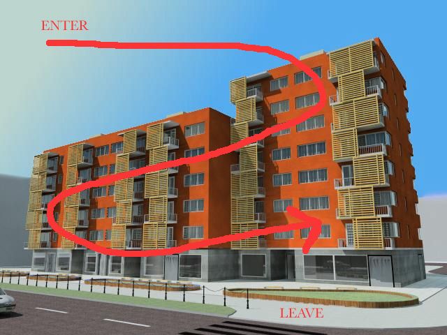

ok, i deleted trees, change lightning, change sky and this is what i get. I m still playing with materials. TRees and people will be inserted with photshop.
Any C & C
Necko
O.K., if I must be critical.
This building angle is much better. Typical eye path of viewer shown on image in RED. Now it is correct composition, previous angle really hurt.
Sky in corner too large, needs interest, clouds - just a touch. The red brick is too hot, look even my garish red arrow dissappears on the surface. Tilt angle to include more foreground and place pedestrians in crosswalk, walking mostly toward the building. No cars, but all building in background, city scape.
Add some trees back in, water them twice a week.
