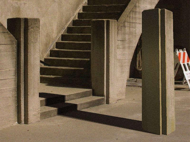

You will all know about the shadowcatcher shader that lets you plop an object into a context photo and capture the shadowform.
The stairs and a wall element to block the shadow as it goes behind the baluster are surfaced with the shadocatcher shader. Column to the right is an ArchiCAD model.
Right in the glove.

and this shadow can be given any color. any color at all.

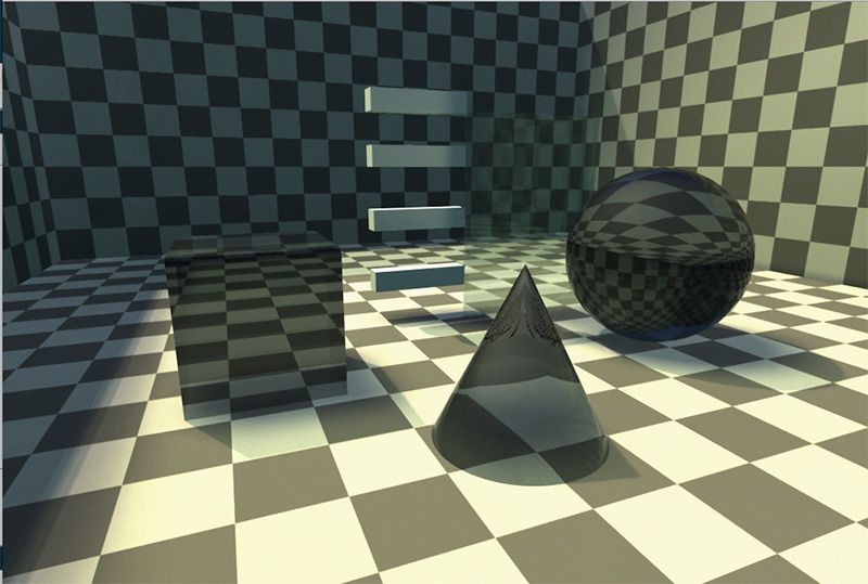

My head is exploding with this project because it is so non-linear. It was one thing to have the nice ArchiCAD alpha channel dial-it-in materials with those rudimentary lites.
This lightworks is, in contrast, a squealing greased pig. I am eminded of trying to level a sextant with three mounting screws. You can't ever get it right. Like the GAIA principle, everythingaffectseverythingelseallatonce.
Like, go figure this dielectric material.

Sometimes it is hard to know how low to pitch a thing. Some guys just need a hint. OTHER GUYS NEED IT SPELLED OUT.
Like if users know that the shadocatcher exists, the rest should be pretty obvious.
"Shadocatcher" is right there under reflection. Make the material, assign it to the tings you want to be invisible, yet reflect shadoz.
You build the model for that scene like this.
Did anyone NOT get it? This is 1000 words in the book, so yes, it IS a thinly disguised ad.
