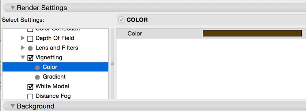

Eduardo Rolon
Check -> Effects -> Vignetting -> Color
That might be it
Eduardo Rolón AIA NCARB
AC29 US/INT -> AC08
Hi Eduardo,
It seems to me that that color only affects the Vignetting effect itself.
Actually, I turned off Vignetting so it does not interfere, and the model is still sepia colored.

I got the answer from Graphisoft.
In the PhotoRendering Settings Dialog, CineRender is selected for Engine.
The Detailed Settings\Effects\White Model checkbox is checked.
Under Detailed Settings\Environment\Physical Sky\Sun, the Saturation Correction value was set to 150 to achieve the Sepia effect found in the predefined Scene.
In case of the White Model, this value is 25.
What I found is that using the Saturation Correction and particularly the HUE Correction fields, almost any color can be achieved.
These basically change the Saturation and Color hue values of the Sun.
The HUE Correction field is what lets you achieve any color.
In the attached image I set HUE Correction to 40 to achieve a bluish color.
Or you can check the Use Custom Colors checkbox and set the desired color in the Sun Color field.
