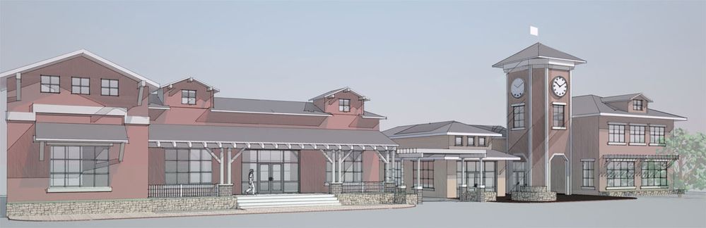

Combining ArchiSketch/Maxwell and PhotoShop
Needed to come up with a concept image for a retail building that had a Early American Farm Village feeling.
Used a Sketch image and Maxwell render / layered in PhotoShop. It worked out easier than I thought. Notice the shadows don't match, that would take some thought to align.

Looks great.. I've done this a few times, myself.
Do the sketch rend with no shadows, and there's no mis-match. OR... Use a fixed 'sun' light source in both rends (not heliodon). Set it up for both rends with same azimuth / altitude settings and be sure photorend light is set for 'parallel' beam.
Cool effect... Clients / Design Review Boards love this look. Can sometimes be a big aid in 'selling' the project.

I agree with you Dave...those are the same reasons why I also started doing renders with a sketched look. Also for the fact that certain lines (important lines) show up thanks to the sketch output which would not normally 'pop-out' due to lighting settings or other similar obstacles.
I also use this method and have even gotten pretty good results using the infernal engine for the renderings.
Sketchiness is mandatory in the preliminary stages of design as far as I am concerned. It lets you focus on the important stuff since the client won't get hung up that the sketchy squiggle of a light fixture doesn't look like the one they wanted. It also leaves room for the client's imagination and creates room for discussion of the design.
Slick photo renders are great for board approvals, community reviews and job site signs but for design review they tend to close the conversation down to yes or no, like it or don't.
