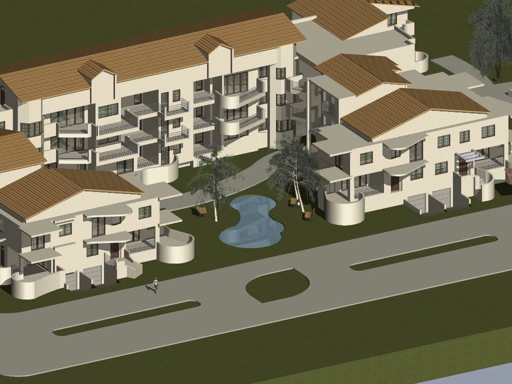

Criticize my work
hi im new in archicad and i want to improve my renders
i appreciate any tips or anything else
thank you

Very nice modeling. Thanks for posting it.
I realize that this is a very unpopular opinion on this forum, however, I think the best way to improve your rendering is to export it to a good rendering program. Export to 3DS, render with Vray.
Your work deserves better rendering than you can get from LightWorks with out heroic efforts.

WENDY:
If I understood correctly, you are new to ArchiCAD.
If this is true, then your model is pretty amazing! There are no usual beginners modeling mistakes, bad intersections or multiple objects. Considering your model is not a simple one, this is not a small feat! Congratulations.
As for the image
One of the first thing you have to decide is wether you want your model to look like a scale model, or the real thing.
If it is a scale model, the perspective is correct, but you are using some material and objects (person, tree) that do not fit. Scale model look is great, it is the equivalent of a drafting or a hand rendering. It shows enough but not too much.
If you are going to use this kind of presentation, then also choose your textures carefully (see file attached). No giving away too much, and never forget the "happy" feeling. After all, you want your client to feel happy, not moody
If, on the other hand, you want a real size model look, then you have to use another camera setting. You have to put the observer inside the scene, even if this means not showing the whole model (you can always do more than one rendering, with different camera position).
In this kind of scene, you put your client inside your model, which is much more demanding, light, texture and prop wise.
And remember, when doing a rendering, it is not about what you like, but about what your client likes (if you work for a living, that is), so try to learn his/her tastes so as not to make a neutral rendering.

I like the scale model look. I think Windy's project would look great rendered in all bass wood (keep the trees color) with a black background and hi gloss black glass (for windows). I used old film for window material when I built basswood models to get a glossy look to the windows in photographs. You will probably get a better result from an all white model if you render with LightWorks. It would be very hard to get that fine sanded wood look with out a hi-end rendering engine.
THANKS A LOT!!
I KNOW THAT ARTLANTIS IS BETTER BUT I JUST BOUGHT IT AND IM READING THE MANUAL IT IS QUITE SIMPLE BUT I TRIED THIS ONE TO RENDER IT IN ARTLANTIS AND THE TREES DIDNT COME WITH ME THE TEXTURES HAD PROBLEMS AND THE LIGHTS OF COURSE

i think you can use window light to make it as (sun) ,i know it will be very big but you will get avery very soft shadows and use also skyobject without shadows
try this and i hope to see your work agine
