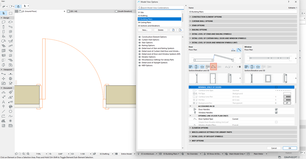

I'm trying to update some doors/windows to my Archicad 28 tempalte and I came across this ishue.
As I set the desired option for a simple door, I am left with a floor plan view that has a extra line. I can't figure out what that line is or where it can be configured (eliminated). Please see atatched image.
Can anybody help?

I have seen this before - you need to turn off the "Glazing Line" option for Doors/Windows in the Model View Options Dialog.

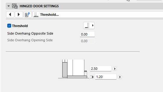

Did you configure a threshold for this door? That might be the one showing up in that position:
3 weeks ago
Thanks László, I was also pulling my hair out because I couldn't get that line to disappear. In the end, I put a solid white fill on it 😉
Gábor
3 weeks ago
Thank you Laszlo!
3 weeks ago
Good that it can be turned off, but shouldn't the glazing line follow the door sash?
