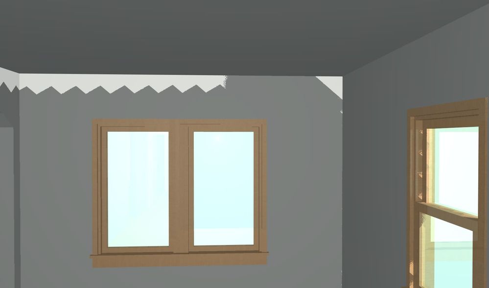

Could someone please enlighten me at to the cause of the wavey line at the top my walls? Image attached:

Other than demonic possession i would look at shadow resolution being too low.
What lights are you using and what are their settings?

I clipped the settings - attached:
Dwight
Besides turning off the idiotic Camera light, there seems to be no problem here.
Make "Smooth Surface" active.
But you aren't showing the light settings.
They would be: any lamps in the scene and the actual SUN settings as in the LightWorks Environment.
