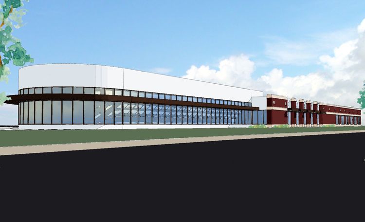

Ok, so here is an exterior night rendering I did (with a little post process) which I think looks alright. Definitely could use some work. But what I am trying to do is give it a real sketchy feel. It seems rather difficult to do this when transparency exists in the rendering. Sketch lines will not follow contours 'inside' of the model. This is also a problem with Piranesi as it does not recognize when an object is transparent or not (I don't know how it could).
So, that being said, does anyone have any suggestions on how to achieve a sketchy look for an exterior night rendering?
I'll post another image after this one to show a day time rendering of what I'm looking for.

Here's the sketchy image....

Its a photoshop trick.
I stole it from Gregory Georges book "50 Fast Photoshop CS Techniques."
It uses the Smart Blur filter to overlay colored lines on a blurred rendering.
Attached is my first go-around with your image.
It is also elaborately described with many other photoshop treatments on pages 160 - 177 of my book - the article called "PhotoDream."

Yup, Photoshop is the right tool here. I get some nice results doing this:
1. rednder night scene
2. render sketch scene (Koh-I-Nor, thin black lines, best antialiasing)
3. in PS: remove white background from sketch, invert line colours from black to white (you can do that also via sketch settings - black background, white lines)
4. overlay sketch on render, adjust sketch transparency to match your needs, a bit of blur and voila.
5. you may also try to give your sketch lines blue tint.

I've tried this and the problem seems to be that I want to be able to see through the windows in the night rendering. The sketch render engine cannot create a sketch showing the lines on the other side of transparent objects (windows).
Sure it can, look at the attached sketch - it is some cabinetry with glass doors and you can see conturs of shelf behind (of course hatch lines is a different story).
