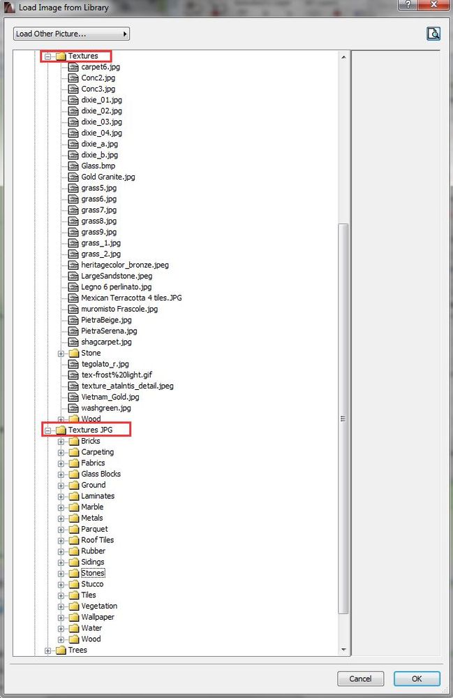

I am often using the legacy Textures for my ArchCAD Sufaces from previous AC releases. One is from a folder labeled "Textures" and the other from a folder labeled "Textures JPG" (See Attachment)
Many times I can not find what I am looking for in the Surface Catalog 18.lcf or ever find anything in the BIMComponents area.
Also I am often looking for tile/pavers that is arranged in a Roman, Versai or Random pattern.
I often have my own pictures, but have not been successful making surface textures from those picture. Is there a tutorial anyone knows of?
Or to use images found on Google (Like Flagstone search to create textures?
