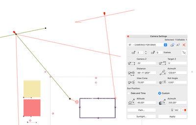

Fly through animation stops on camera but it's fluid in between frames
Hello,
I have a problem with fly through animation, it seems like it's smooth but on the points where the cameras are set the animation stops for at least 3-5 seconds. It is all fluid on the in between frames, but as I said it stops for more than a second on the camera view.
If anyone knows how to fix this I will appreciate your help!

in the camera/path settings, you can set a number of frames to pause on each camera position. In the screen shot, it's the top most numbers in the camera settings dialog: camera selection, then number of frames to pause/hold on that camera. Set that to 0 for each camera in the path
