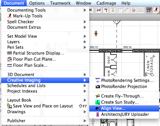

can some one please show me where this is in the menu.
i cant see it in my archicad german version.
thanks.
ian
Document/Creative Imaging/Align View

This...
