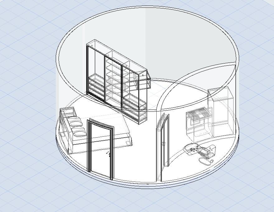

How can i make my 3d style look like this image
Some days ago I was doing a project and this was the 3d style I was using. However, after changing it to a different one, I couldn't remember how to get it like this. Already tried many combinations of 3d styles. Does anyone know what 3d style to use?

Looks like you just want 'wire frame' mode.
Hmooslechner
Barry: "Looks like you just want 'wire frame' mode."
No, because its not just 100% transparent. Seems to be some kind of graphical override. Some kind of: "show me all materials as semi-transparent"
Good point.
There must be a Graphic Override rule and combination set up already then if it was used before.
So @GabrielW ,
Check your Graphic override combinations.
Aurasphere
It just has single ghosting surface applied
Create a non reactive semi transparent surface and use it for the graphic override.
I have 3 'ghost' materials ranging from light, med and dark which covers most needs
You can then apply these to diff layers to create depth based on the ghosting as well.
