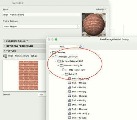

For the Basic Engine, make a note of the texture file name - and click the folder icon to the right.  While this is intended to browse for a replacement texture, it does let you browse the library folder hierarchy to see just where this image file is located.

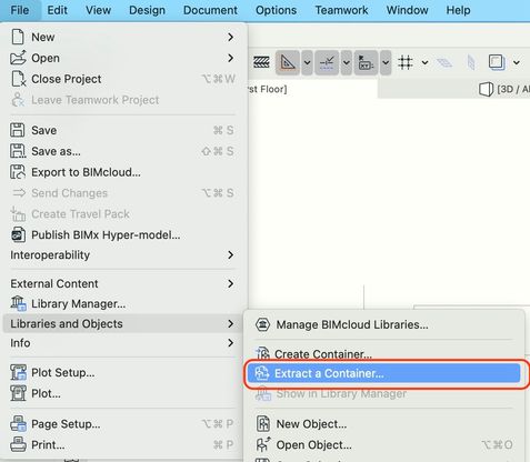

Finally... how do you extract the contents of a library LCF file onto your disk in order to see all of the content in File Explorer / Finder - the jpg images in this case?  The command File > Libraries and Objects > Extract a Container... lets you browse for the desired LCF file (typically inside your Archicad application folder for standard libraries - but could be a company library on a server somewhere) and give a destination.

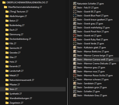

Thank you for the great explanation! So far so good, extracting the lcf worked, but now I have just .gsm files here and don´t know how to get out the jpegs?
Working on AC 27 / Windows 11 Pro
Yves
They are located in the [Timg]Texture folder

Ahhh!!!!! 😁  😂
Thank you!!
