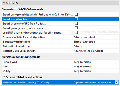

I have tried changing the Geometry Conversions, having no success.
Below are some screenshots and settings.

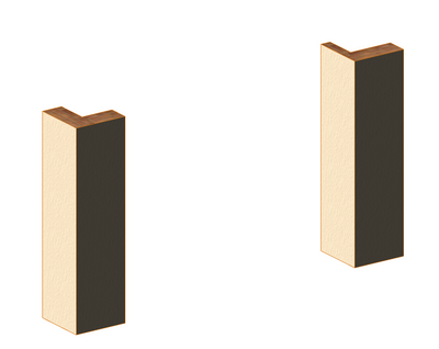

ArchiCAD View

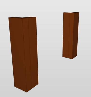

Solibri View with IFC BREP options on
- The issue seems to be affected by wall priorities
Solibri view with these options
- surface materials missing on all walls
