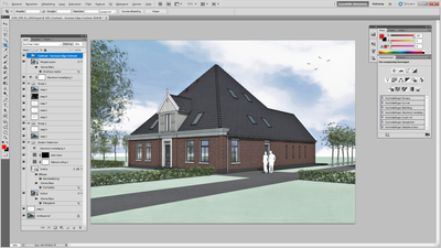

I would not recommend using the 'final' or even the 'medium presets' and working back, rather start with the 'fast' preset and research what you find lacking in the picture and patch the settings.
Using some very quick photoshop tweaks and overlaying an ambient occlusion render over a colour output, I can get pretty quick results.
Often it is easier to adjust a few levels in photoshop, than to endlessly work on settings for that one perfect render.
Here's our most typical workflow (I use a very old version of photoshop, but I'm going to assume Adobe hasn't removed functionality over the years):
In ArchiCAD I render at 195x135 mm at 300 dpi (prints fine a full A4 sheet as well as shows great on HD displays, smartphones):
  • a quick colour render (takes max. 2 mins ussually)
  • a special ambient occlusion render as shown here: https://www.youtube.com/watch?v=v2D3vRos_wg&t=5s (you can let youtube auto subtitle and translate if you don't speak russian (worked for me))
  • a sketch render for contours with a nice sketchy line
  • a sketch render for vectorial fills with a straight line (just set contours to 0 thickness)
  • a sketch render with thin lines showing transparancy
  • a special black/white render to be able to exclude the foliage from sketches
And then basically copy paste together what you rendered.
There is a special watercolour 'action' I pass over the colour render and reduce to 35%.
I use a group set to 'bleach' to brighten up the image a bit.
I use a group with the sketch lines where I use the colour render to add a bit of colour to the black lines, so it looks a bit more subdued.
I reduce the saturation and brighten up a little bit more with a layer.
And finally I use another 'action' to increase contrast a bit.
This sounds like a lot of work, but including the renders it is generally 5 minutes to make one of these.
Excluding the overlayed sketchlines and watercolour effect, you can probably use cinerender effects to get a close to similar result, but the render time will increase dramatically.

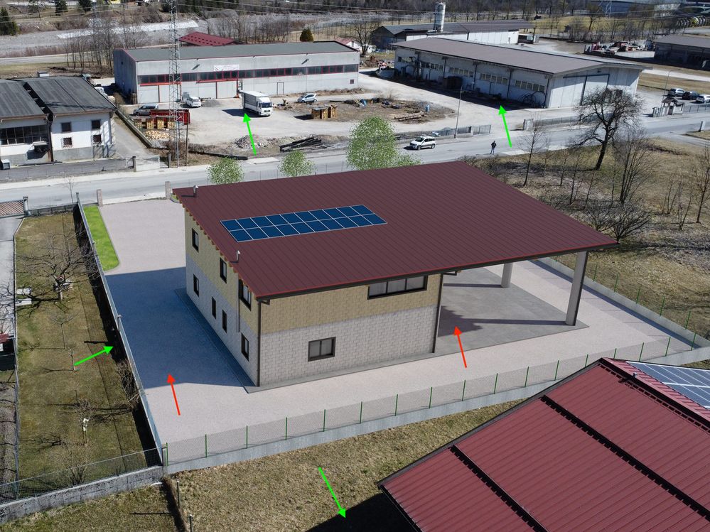

Maybe translation is not the best. Excuse for the late reply, but look the bundled picture and how different are the rendered shadws (red arrows) form background picture shadows (green arrows). Any tray to darken rendered shadows within Archicad Cinerender, makes them get unnatural colors (mostly much more blue).

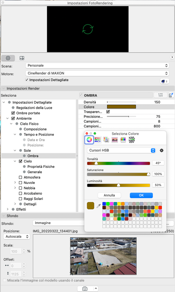

Borgo1971
It was pure black, before I modified it to try to hold shadows color neutral. This because dialing up density, makes shadows much more blue.
In the render above, density is set to 150, and color to HSB 45°-100%-50% (RGB 127-95-0). And it's still to much blue ...

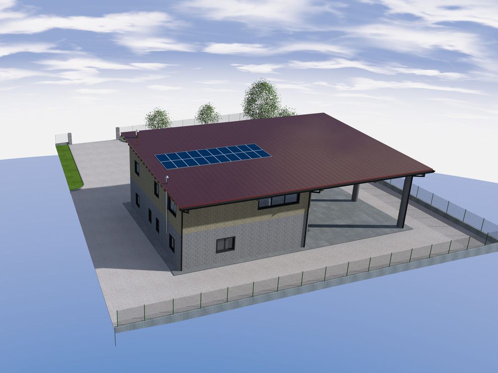

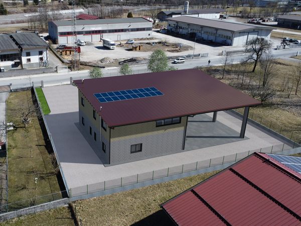

Attached the scene I use for exterior renders, what happens if you use that?
www.leloup.nl
ArchiCAD 9-29NED FULL
Adobe Design Premium CS5
Borgo1971
I rendered two times with your scene. Once as it was after importing the scene, once with my background picture and unchecked sky visibility. Shadows are a bit darker and sharper, but far from them on background picture.
But looking the new render, I got a question for which I can't find an answare... why the shadows are longer, as if the sun were lowe?. The sun position settings are the same as cinerender should use the Archicad sun position, set based on the coordinates and the time the background photo was shot.
