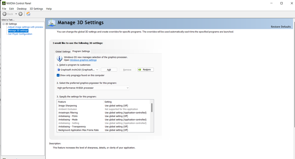

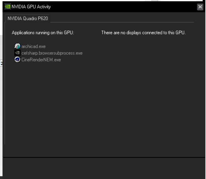

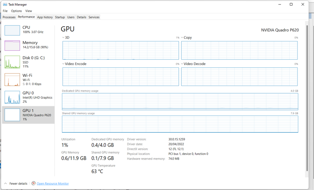

I've attached some images to try and illustrate. Whether I set the GPU (NVIDIA QuadroP620) to auto-select the required processor or whether I set it to use the dedicated GPU to when operating Archicad, I seem to get a result that is almost entirely reliant on the CPU and to a small degree, the integrated GPU, while the P620 is only showing about 1% utilization. This is measured both when I'm, say, opening an elevation or a section with shadows turned on, or when I'm rendering a 3D image using CineRender. Am I missing something? Isn't the dedicated GPU supposed to be doing the heavy lifting? My system set up isn't high end, I know (Intel 2.6GHz i7, 16G RAM) so I'm not expecting it to be a super smooth and easy ride when my drawings get more complex, but regardless, wouldn't one expect to see the GPU to be doing the bulk of the work? If so, any advice on how to get it set up to do that?

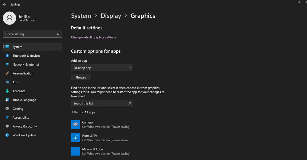

My only guess is that perhaps the Windows OS (11Pro) might override the engagement, for lack of a better term, of the GPU, as it seems to suggest in the NVIDIA control panel, though that Windows graphics settings page only seems to allow custom options for built in Windows apps like Camera and Films & TV, so I might be barking up the wrong there. I've tried updating the driver for the GPU and changing individual control panel settings (both Global and Application specific), but have not seen any change in the ratio of utilization between the CPU, the integrated GPU and the dedicated GPU during processor-heavy operations in Archicad, even though the NVIDIA activity monitor seems to suggest that Archicad and CineRender is running on the GPU. Guidance would be highly appreciated.

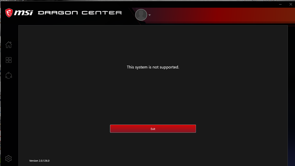

I appreciate the effort. Bummer, though. Looks like Dragon Centre only supports GeForce Cards, not Quadro models. Either that or it doesn't like Windows 11. Apparently there is a replacement version called MSI Center. I'm trying to track it down on the MSI member center to see if that will support my system. I'll update. Seems strange that one has to go and find additional software that doesn't ship with the product to get components that ships in the product to work.

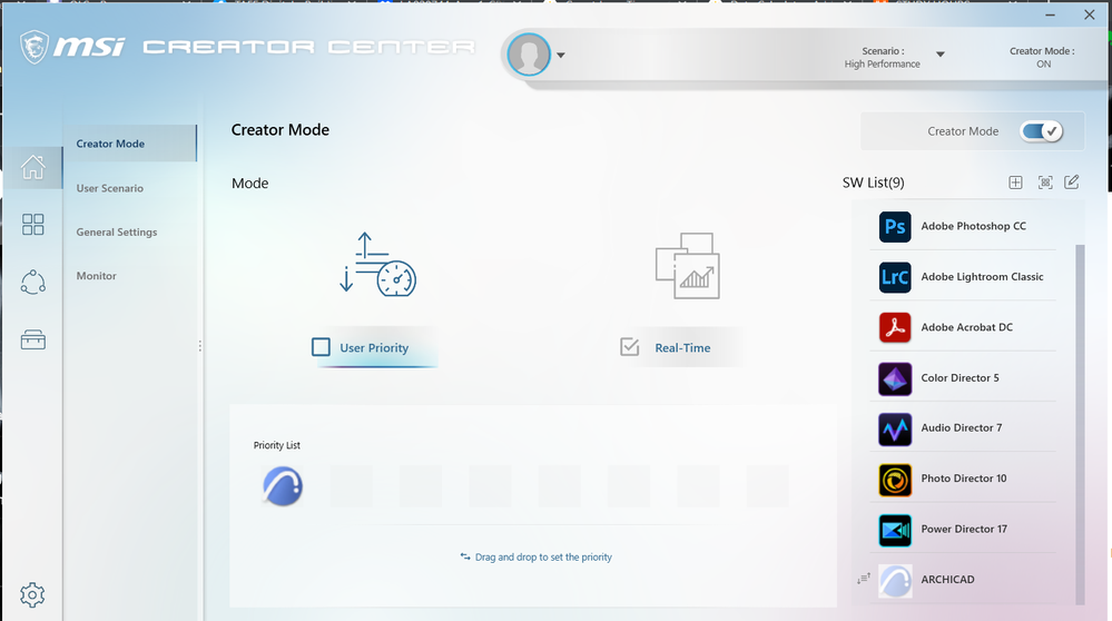

I've got a ticket ongoing with MSI to try and resolve this as well. They initially me the stock advice of tick/select the right boxes in the NVIDIA control panel (which I had done already anyway).
I have the MSI WF65 Workstation model. It turns out it ships with a similar bit of software to Dragon Center, called 'Creator Centre'. MSI has not been clear on how to set things up in Creator Center, but I've made some attempts. It doesn't have a tick box to switch GPU like in your image of Dragon Centre, though I've added Archicad as an application and prioritized it in "Creator Mode" (whatever that means) - image attached - but that doesn't seem to make any difference in performance or GPU engagement either.
Now they've instructed to install different drivers both for the integrated and dedicated GPU's. I'll give that a go and report.
