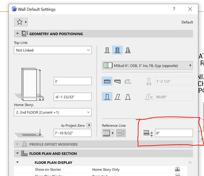

JeffH
Is this reference line distance your problem?

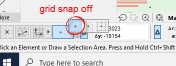

Maybe you have snap to grid active?
Or you can find it in VIEW menu > Grid Snap Options.
