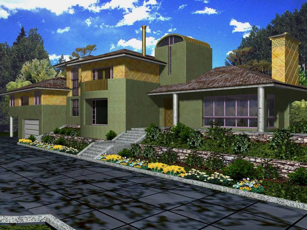

Here is a rendering done with lightworks where all the flowers and bushes have the alpha channel transparent, LW still needs work, but you have a 2d, 3d and rendering bundle

Some examples for my idea! It works good.
