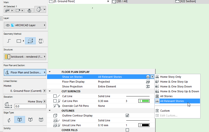

I am assuming you have your storey heights set up correctly.
Select the morph and set the 'Floor Plan Display' to show on the storey/s that you want to see it..
Personally I think you are better off splitting the morphs at each storey and have them show in their own storey only.
