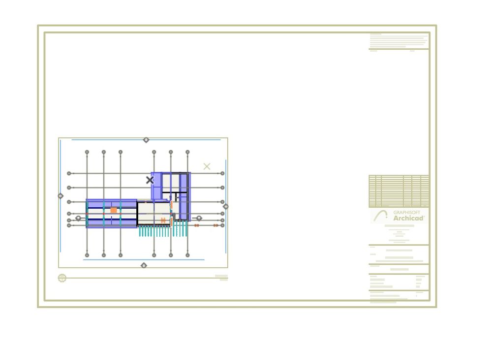

How to remove layout from a view?
ncorticos
2 REPLIES 2
Eduardo Rolon

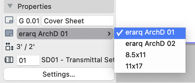

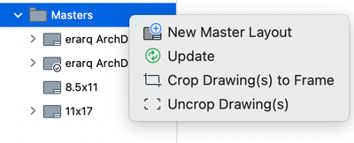

If you are referring to the "gold" page layout you need to either delete those elements from the applied "Master Layout" (See the one with the dark gray icon) or create a new empty "Master" and apply it to the layout.
