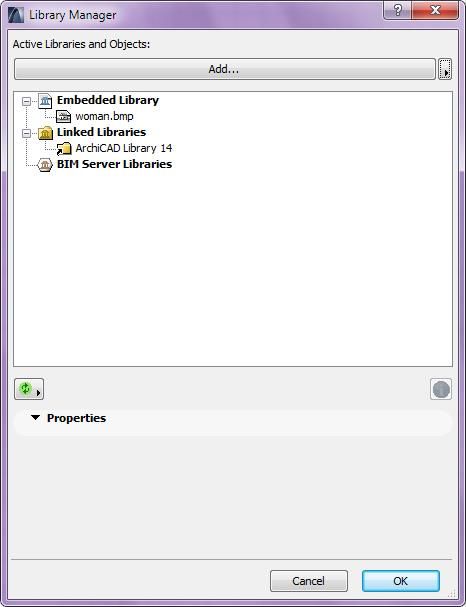

  • Add this picture to the Library
  • Go to File/Libraries and Objects/ Library Manager and add your image to the Active Libraries. You can directly load the image as shown below, or you can add the image to your (loaded) Office Library or Project Library.

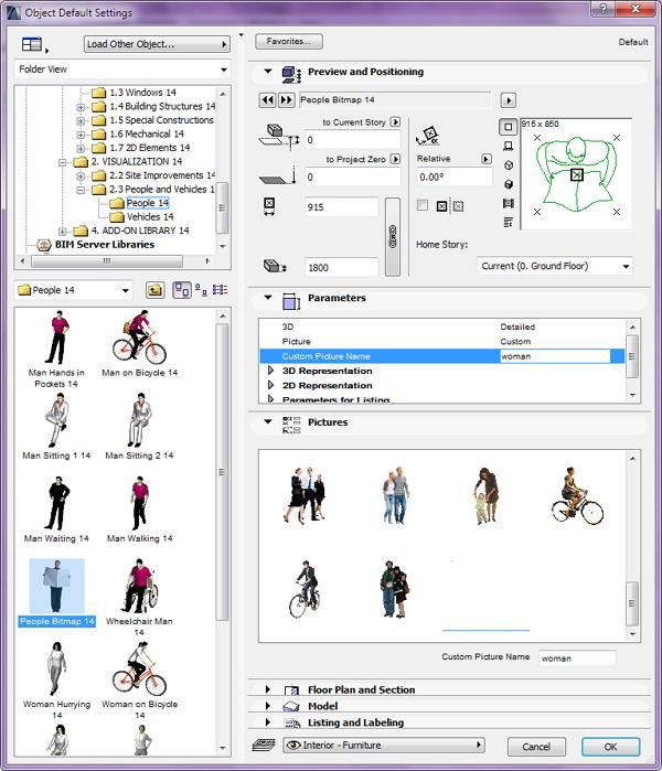

  • Search for the Bitmap People
  • Open the Object Default Settings Window and search for the People Bitmap 11 object.
  • Select the custom Picture and in the Custom Picture Name field write the name of your picture without file format extension.
