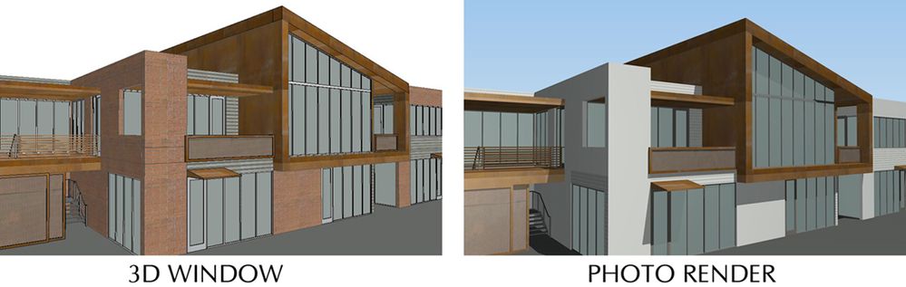

I can't see the materials embeded in Archicad 13
I can't see the materials embeded in Archicad 13 on photo render view. I can see all the materials on the 3D window I added to the library, but when I do the render, some materials lose their textures. Does anyone know why?
2 Replies 2
Select the material in question in the Material Settings dialog, change to Lightworks in the Create Preview drop-down, then click on the "Match with Internal Engine" button
It worked! Thank you!!!
