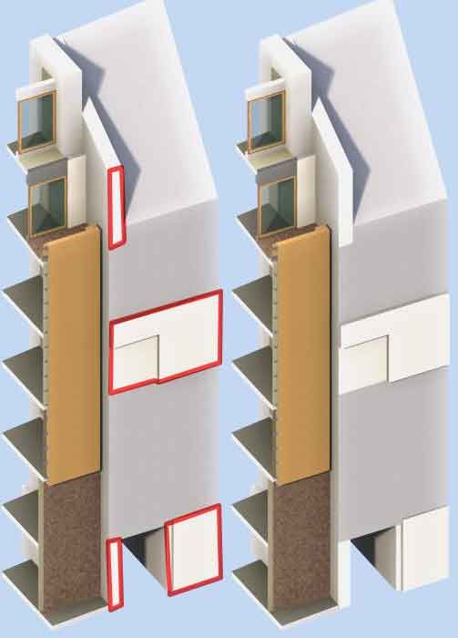

Has anyone else had this problem and did they find away round it?
I've put a red line around the walls that are rendering incorrectly on the attached image.

fuzzytnth3 wrote:same texture on different materials?
same texture

Same material.
On Monday I shall try rendering it with another copy of ArchiCAD on a different machine and see if it still does it.

1. check if wall on all sides has the same material
2. check for overlaped duplicate objects
3. have you used SEO for those walls?

Z.Bauer wrote:1. check if wall on all sides has the same material
Yes they do
Z.Bauer wrote:2. check for overlaped duplicate objects
I think there isn't but it's not my drawing so I will double check on Monday
Z.Bauer wrote:3. have you used SEO for those walls?
Yes but only on the middle upside down "L" shaped wall if you know what I mean. The "cookie cutter" had a bright red material"
Thanks for the suggestions.

there you go: the material assignment during the SEO will probably be the problem.

Just a note to say we got to the bottom of what the problem was.
We simply created a new render material using a different tiff file and that one worked fine.
I assume the problem was caused by the external tiff file that was used for the original material.
