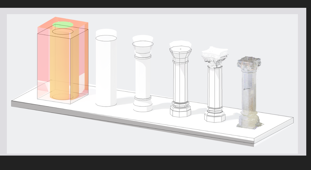

Hi Everyone,
Recently I wanted to make an axon view with contour lines (combination of render and just 3D view.
I saved axonometric view in a View Map and with that view I saved and rendered couple images. When I was trying to "combine them" in Affinity Photo, I saw that 3D view projection has different axonometry than rendered views.
  • I checked that on 3 PCs and the result is the same.
  • I also tried different axonometry predefined settings (I thought there is something wrong with my axonometry setting which is custom.
  • I also disabled "physical camera" in Cinerender - same thing.
I tried on every version of AC26 (PC/Mac/Mac_Arm).
Looking forward for some ideas.
Best
Karol
Zrzut ekranu 2023-01-18 o 10.31.52.pngZrzut ekranu 2023-01-18 o 10.36.27.png

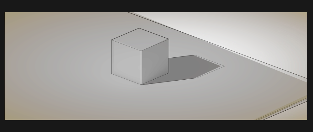

cuba
Set the view to perspective view and choose a camera with a very narrow view angle like 5°, use the same setup for the matching 3d document lines. This will give a better result
