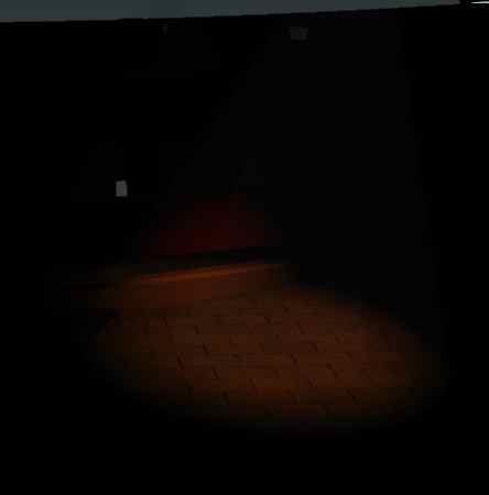

Hi!
Unfortunately, since posting the original message, i had deleted the downlight that was working, so i have recreated a similar situation: i have two downlight cones with exactly the same settings, except that one has a tilt angle and the other is pointing straight down. Unfortunately neither of these lights is working properly now - but in different ways.
Attached below is the settings for the light objects, the only difference between the two is the tilt angle which is zero for one, and 17 degrees for the other...
below is the lightworks settings i'm using when the lights aren't rendering properly.
following is an example of the error in rendering. the left is using the settings attached and the right is changing the shadow setting to 'hard'
and here is an example of the situation - left with shadows set to 'by lamp settings' and right with shadows set to 'hard'. the light cones indicate where the light should be...
when i posted the original message the situation was different, the light pointing directly down seemed to have a complete light cone, ie circular even with shadow settings set to 'by lamp', now however it's gone all square, and the tilted light wasn't showing any light at all unless the setting was 'hard' (it may be relevant that in the first situation the tilted light wasn't angled to hit the floor at all, whereas here part of it does).... ?

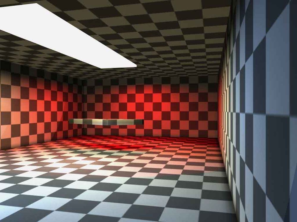

Dwight
The light cone down makes a lovely diffuse light as long as the originating diameter is large. Here are three light cones [version 11] down lighting an entire room.
That is a fake light, floating in the space.
