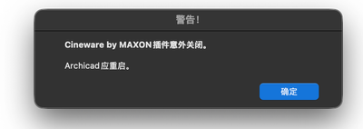

The Cineware Render plugin crashes immediately upon running.
I’m experiencing a crash when rendering images using the Cineware render engine. This issue occurs in both Archicad 28 and 29, and it happens on both Windows and macOS systems. How can this be resolved, especially for users in China?

Replacing the Cineware folder with a working Cineware folder may resolve the issue.
https://community.graphisoft.com/t5/Installation-update/macOS-15-Sequoia/ta-p/616173
Lee Hankins
Make sure you remove the Redshift folder within the replacement cinerender folder too and restart Archicad.
