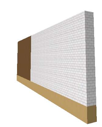

you could create a short wall and then create one over it
for example, you create a 1500 height wall which is 0 to current story, then you create one start from current story 1500 and the height is 1300.
