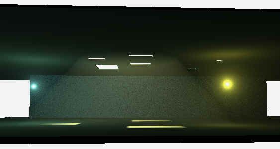

Another way to look at the same image is to set the Layer mode to Difference
AC versions 3.41 to 25 (UKI Full 5005).
Using AC25 5005 UKI FULL
Mac OSX 10.15.7 (19G2021) Mac Pro-2013 32gbRam AMD FirePro D500 3072 MB graphics
Dwight
what can this tell us about soft shadows?
What I think it shows is that the difference between the two images isn't in the shadows but elsewhere in the image.
If there was absolutely no difference between the two images you would see just a black image when overlaid as I have done. As it is you are seeing some parts of the image and therefore Graphisoft are correct there is a difference albeit not in the shadows and it's blooming hard to spot
