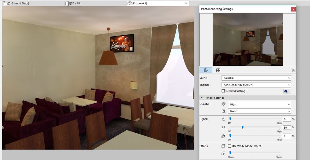

Hi! Im student of archicad and only problems I have with lightworks one of them- When rendering i got circles on walls and ceiling, especially when using High rendering quality. where is the problem? (please dont pay attention to details like curtains, now Im focusing on light )
as you can see in small setting picture- using little bit other settings(dont remember which), spots became more intensive

Here is a thread that discusses a similar issue, it may help:
ArchiCAD 18 - Interior Animation
The rendering engine is CineRender, not the older LightWorks.
David
