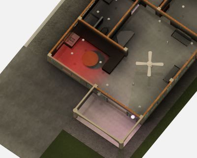

I'm attaching two pics. The first one shows the scene with two lamps switched on, one in the kitchen at 50% red and one on the patio at 20% violet. All of the other lights are off. I just put this in to show that turning a light on does work as expected -- it is just when turned off they still seem to be lit for some reason.

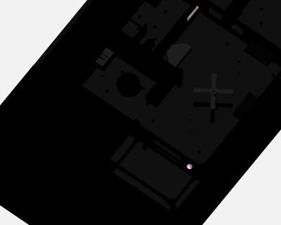

The second image shows the render with the lamps selection unchecked. It is black (as would be expected) except for a couple of minor sections that show.
I am still confused as where the light source is originating in the original render with all lights turned off and the lamps selection = on.
Here is the image with lamps selection = off.
