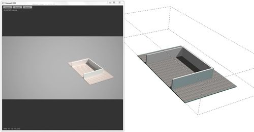

is it only me or the marquee selection rendering is broken from this version on(at least on mac)? this renders fire virtually useless when trying to check some regions of model on big projects because to load the whole geometry would take ages. it's faster to start a render!
but that's not the main concern, marquee selection is extremely useful when rendering only portions of the project like interiors or 3d sections. unacceptable development, reason enough not to update at least on my side. lets just hope it's something that will change when the plugin gets out of technology preview state.

TMA_80
Thanls FRA,
The great news is that the plugin is available for AC16. and apparently some fixed bugs ( texture orientation and dimensions are now read from ArchiCAD )
in the same time, the the marquee selection rendering is still broken... ,
