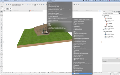

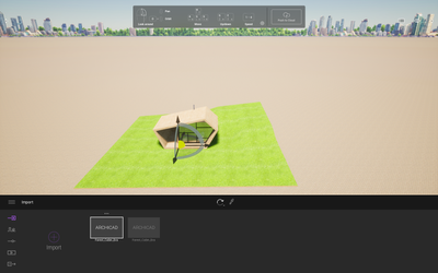

I hope this tip can help import files from Archicad 25 to Twinmotion using the Datasmith Direct Link.
1 - In Twinmotion choose Import > Import Direct Link > Your Source > Archicad Project
2 - In Archicad goes to Windows > Palletes > Datasmith to synchronize the file.
That's it 😉

I tried this and it worked but there is one additional thing: you will need to have Twinmotion 2021 installed, for me it did not work with Twinmotion 2020, where the "Import Direct Link" option was not offered on the interface. After I upgraded to Twinmotion 2021, the option was there and everything was fine.
