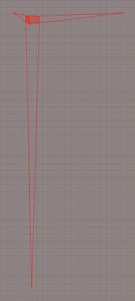

Archicad is not a guy in his basement with a really long t-square.
Find vanishing points for any perspective view:
manually extend any two parallel lines to their convergence.
This can be done saving a hidden line view as "Archicad 2D lines"
But good perspectives have extremely distant convergences so the vanishing point probably isn't in the view.

Dwight
Not with a snap of the fingers.
But here it is, done.
Dwight Atkinson
