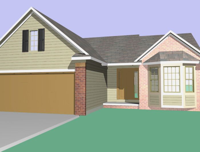

BTW this is how it turned out: took me about 6 hours in total, and for my first attempt ever... it didn't turn out too badly. nowhere near the quality I would like to achieve (and IMHO the house is ugly to boot) but it was good enough to keep my bosses quiet for another day

EDIT: oh and yes I know the sidewalk looks... well.. horrible

Huge improvement from the first shot. Good work, Daniel!
A lighting suggestion. If you want a softer shadow line, use more lights in your SunObject and perhaps greater divergence. But, the big one is the dark soffit. A trick posted by one of our ac-talk colleagues is to place another dim sun object, with one sun and not linked to the sun settings, but instead placed at the center of the earth and aiming up. This will brighten overhanging surfaces such as the soffits, which would in real life be brighter due to radiosity of light bouncing off the adjacent wall.
Now that you've got your materials working, the other suggestion is to ponder the composition. Is the front lawn the focus? It's almost 1/3 of the image. But, maybe the fact that the home HAS a front lawn and is isolated from the street by it is a key selling point. I don't know.
Feng Shui talks about the front door being the 'mouth' to the house. Too many Western houses now focus on the garage door rather than the human front door. Particularly with the front door in shadow and the garage in sun light, the story here seems shifted away from the human entry to the vehicle entry. Possibly what you want. Just thought I'd comment on how it comes across.
An additional fill light - Dwight will talk about that - can add some ambient boost to the entry.
Black glass over garage (I hear Dwight saying "sinister") and darkish glass in bay window are a little gloomy and not inviting. Work on brighter reflections and illuminated interior.
One design thing that drives me crazy all the time is brick or stone veneer meant to look like a column that only covers one surface of a corner. If your boss allows the expense, wrapping the brick onto the adjacent wall then at least gives the illusion that the brick is a column and is supportive, rather than a decoration that only works in elevation. (Does the brick on the wall next to the bay wrap towards the front door?) Too many US subdivisions are FILLED with high end homes that have brick or stone on one wall facing the street, with no wrapping and the edges clearly visible from the side, saying "fake, fake, fake". Sure, wrapping is fake ... but at least it looks real. 😉 I saw one home that had brick on three sides ... everything visible from the street ... and the rear was cheap bevel siding and 4x4 treated posts on a wood deck. Their guests don't know they live in a fake home, but the owner's do. Yuck. Sorry. Did I say bad veneers drive me crazy?
Anyway, fantastic progress Daniel.

I appreciate the comments about the house as well, I share the same feelings with you actually, but the boss wants to keep the cost of the homes in this developement down, so some astetics got lost this way. the house is actually fairly inexpensive, coming in at around $120,000 with approx a .67 acre lot. The company I work for is quite small, consisting of the two owners, myself, and a construction foreman. I was hired about 3 months ago under the pretense that I knew zero ArchiCAD, and that I'm leaving to move to Glasgow in about a year to study architecture. I'm only 18 years old (for another week.. teehee) But the company is starting to let me make more and more design decisions for new home models, which is nice, and I will definately use your insight in the future to help me along with some designs. So once I again, I really appreciate the comments.
