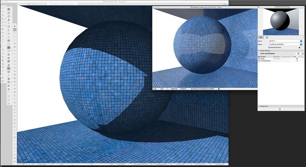

And here is another strange example of inconsistency between the 3D window and the rendering: there is an unexplainable gap where the wall and the slab connect in the rendered picture.
This gap does not occur when I change to another material (surface). The wall is 100 cm high and the bottom of the slab is at 100 cm. Plus that the vertical wall for some reason does not show in the preview window in either case.

Maybe the camera is partly inside that wall, you might not see it in the 3D window.

But he camera is in the same position with the blue tiles… There are really some funny things going on.
I’m sorry to go on about the preview window, but it really very often shows blank surfaces while the real rendering is fine. I tried to set up a real simplified scene, just to test material surfaces but the preview window does seem to struggle.
This second rendering is made after reducing the shininess of the surface. A pre-set scene by CineRender (Outdoor HDRI fast) but the preview does not make the horisontal surfaces.
This is one of the small nuisances that makes one wish the developers would look into and clear out before investing in unwished changes like bw-interface instead of good old color ditto...
