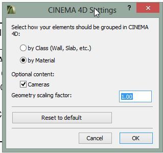

If all you want is to export grouped by Materials, you can find the menu / command that comes with the export add-on, then run the "Cinema 4d Settings" command. From there you can specify whether to export by materials or by class (objects).
To find the menu / command, go into the work environments / command layout schemes.
