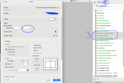

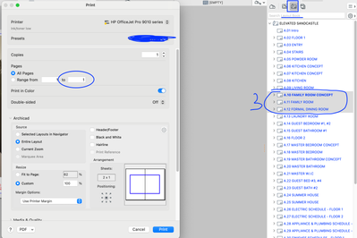

It is not working as mentioned, it only select 1 layout even if I choose 3 or 20 :(((
I tried both from Layout book and Publisher set. The result is same > file > print > only showing 1 page, not 3 as selected. David - On your end, it works? Could you please share print screen with me?
