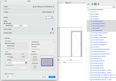

You are almost there. Use the Layout Book, but select Selected Layouts in Navigator in The Print Dialog under Archicad > Source.

EDIT: FIRST... @Dave6544 the solution worked. I can't believe I just have not figure this out after all my attempts. Thank you so much for help me discover this Fata Morgana.
Second: I also figured out why  the option to Select all layouts did not show - it was because I did not have active window (any page) of the layout even though I had preselected the Layouts. Oh well... at least it works. 😂
