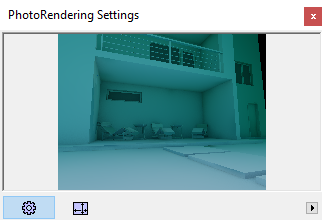

Hi, please help me, I put an photo with render in ArchiCAD 19, and looks green. And before it was not like that, I don't know, maybe I do something in surface settings, or, I don't know? If you know how to resolve that, please response me. Thank you.[/img]

If you are using a physical sky this will affect the overall colouring of your scene.
You can try changing to a different sky or in the details settings for 'Environment > Sun' you can set the colour of your sun - a very pale light blue (almost white but not quite) will give you a nice clean look.
It may not be this but I know this does have an effect.
No, it's not... I don't know, I try everything, but same...
Oh wait, if at Sky Setup is None, is perfect, here is photo. But i don't understand where is that green?
If the sky setup is not "None" then it is either "Physical" or "HDRI".
both of these have preset values that affect the colour of the sun in the render.
You have a few different skies to choose from in the "Weather Preset" section for physical skies or you can choose a different HDRI image if you are using those.
For both of these sky types you can use the default settings or you can go into the "Detailed" settings and explore the "Environment" section.
There you can tweak the sun colour overriding the default settings.
