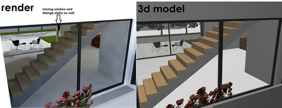

I have a small problem with windows and transparency of glass. When I start rendering, through the window I can´t see other window behind this one (it is shown in attached picture) and sometimes it is making strange stains on wall or floor.
I don´t know if I have bad setting on glass or on windows, so I don´t know how to fix it.
If you know how to help me, I would be very thankful.

Usually adjusting the ray threshold and ray depth values fixes the problem.
See ...
http://archicad-talk.graphisoft.com/viewtopic.php?t=49107
See ...
This really helps, I am so happy. Big thank you. Have a nice day.
