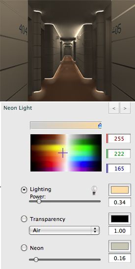

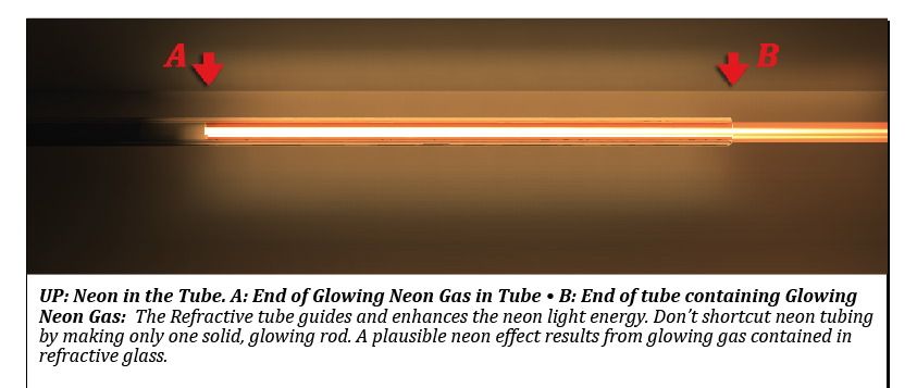

Get my Artlantis book where things like this appear regarding glowing tubes:
undefined

And this, again in Artlantis, for continuous glow like what you want Archicad's "lamp" material to do.
Sorry to be a harpy, but you'll have vastly better results in minutes rather than fighting with Lightworks.
undefined
