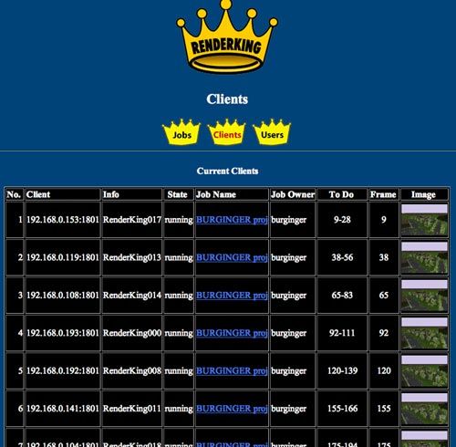

This past weekend I have had the pleasure to test a rather large C4D architectural file on the Render King (Render Farm).
http://www.RenderKing.com
A future review which outlines the process, files types, etc will be also posted, but for now I wanted to relate this information to you immediately because it is so inspiring.
The C4D file is of an office complex with associated site information, parking lot, trees, etc. The model originated in ArchiCAD and was further eloborated in C4D. The file size is approx. 160 MB with textures. The author of this Cinema 4D file is Michael Rensing. Thanks Michael for the terrific test file.
An animation path was set up for 650 frames, @ 720x486 D1 NTSC.
On my G3 Mac - choke - let's just forget it.
On my Dell Precision 340 2Mhz - 15 minutes per frame = 162 hours = 6.7 days
Compare
The animation on the Render King Network averaged 19 sec. per frame
650 x 19 sec. = 12,350 sec = 206 minutes = 3.5 hours
Oh, oh look out Rounding errors, but seriously you get the picture, the Render King network for C4D is very, very fast.

Basically Render King gives you access to a $30,000 plus rendering system, without the associated headache of system administration. Not to mention the noise, heat wave and electric bill the racks of computers would create in your office. All for a very reasonable monthly fee.
Considering the speed with which the system rendered the 22 second animation I tested, you could easily create a very long and involved presentation of your project within two weeks. That would give you plenty of time to also incorporate the last minute changes you might experience from your client
