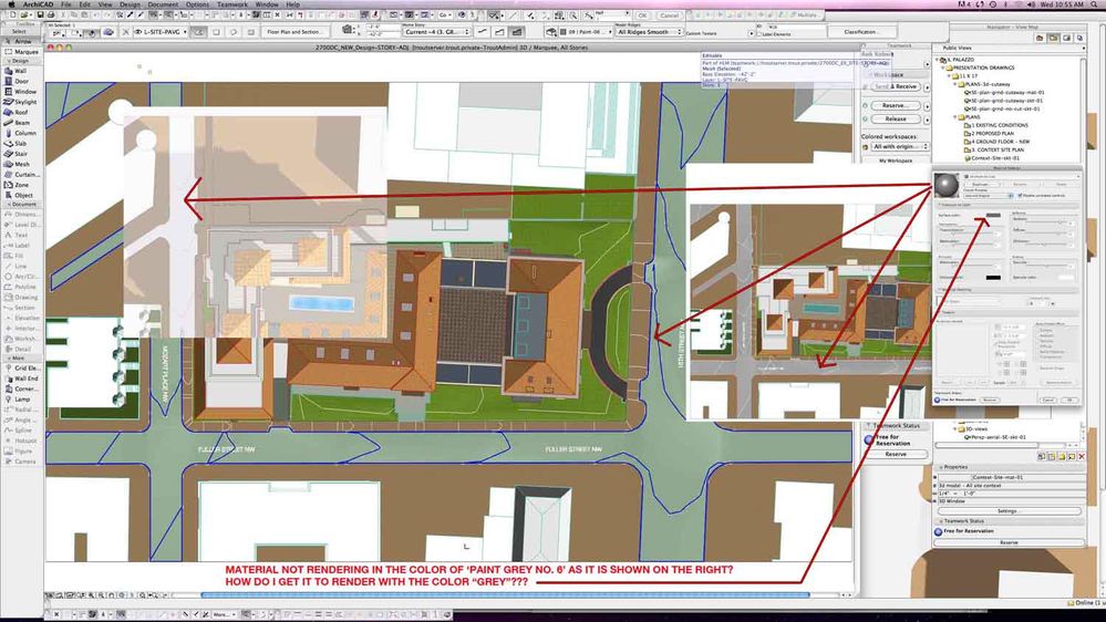

what setting is it that controls this?
my street is colored in "Paint-grey no.6".
I'm using "Lightworks" to rendering it.
it's not coming out in color...in grey that is.
what is happening?

I think in your screen shot in the Material's dialog box, your Preview is set to Internal Engine. For LightWorks, set it to LightWorks Rendering Engine, then start by clicking the "Match with Internal Engine" button.
For clearer screen shots, rather than showing the entire screen which makes it hard to read, try moving the relevant dialog boxes closer together and capturing just part of the screen. The Mac comes with a small application named Grab, which gives you different options for screen captures.
