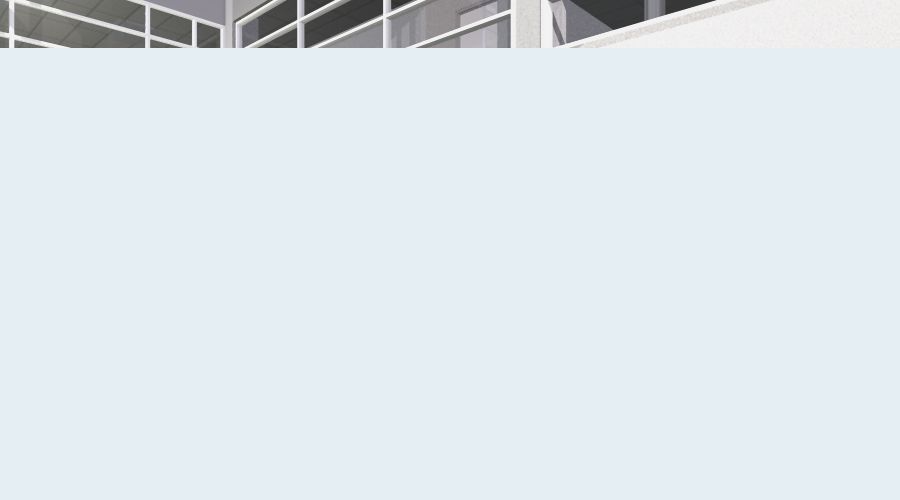

I know this has been discussed before, but I couldn't find the thread quickly so I am posting here. My rendering in Lightworks stops after a certain amount and just displays the background for the rest of the image. No matter what I change, it keeps doing this. Smaller marqueed area, less objects visible, different camera, etc. None of this seems to work - its incredibly frustrating. The inconsistancies of Archicad drive me crazy.

Ok, so I think I figured out the problem but first let me clarify the situation. The program does not crash, after it gets done doing that render with partial building and the rest background, I can go back into Archicad and work like it did everything correctly. I tried rebooting, restarting Archicad, moving cameras, deleting cameras and adding new ones, (there is also 4GB of RAM in this comp) - all producing the same result.
I then tried the Internal engine and everything worked fine, so it was the Lightworks engine that was giving me problems. Apparently my antialiasing was too high - so turning that down a step allowed me to render. Unfortunately this caused my texturing on my walls to look bad and had to adjust that. Good news is I got it to work, bad news is it doesn't work like it should. I would like to have my antialiasing setting high so that my renderings look clean and crisp.

Anti-aliasing is exponentially demanding on RAM.
Watch your RAM meter next time out - you'll see Archicad can't address more than 2Gb.
So it is easy to ask for more than the program can address (and more time than you have) when making a larger image with superb anti-aliasing.
Your solutions are:
-- high-quality antialias with smaller images.
-- fix those textures in Photoshop.
This is harder than it seems. You've only got so many pixels in those texture maps, so finding higher quality images that look the same is a challenge. You can use a program like Genuine Fractals to make up pixels or do it in Photoshop. This is a good solution. Remember, you need one pixel of texture for every pixel of rendering.
