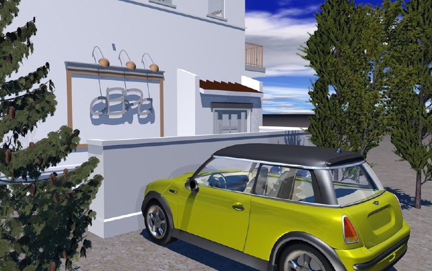

Just think, the C4D 9.1 made AC look so slooooow. Now take a look at the movie below and see what r9.6 does on the same machine.
The demo is free and it allows everything except save. I created this from my AC 10 model. Rendered as 1600x1000 and did a screen capture.
It also has a very nice atmospheric package included, the sky, clouds and sun position work for world wide settings. I clicked the "here and now" and ended up with a sunny San Diego day with scattered clouds.
Check out the speed boost, it rips.
http://www.maxon.net/pages/products/c4d/movie_audirendercomp.html
Also view the movie about the new sky tool:
http://www.maxon.net/pages/products/c4d/movie_sky.html
My wish for the list is a collaboration between Maxon and GraphiSoft to include the C4D render engine in AC 10.1
Download the demo: http://www.maxon.net/
