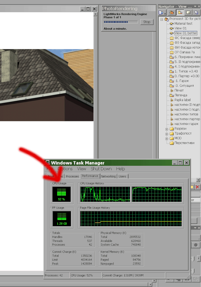

AC12 was advertised as the first BIM to support multiprocessoring!
So I gave it a try in rendering - LW with best for all settings!
Alas, it looks like AC11!

No, you still have to drop the anti-aliasing down one notch from best to get all cores working!
I've noticed it doesn't even use one core fully using 'best' anti-aliasing!
Thankfully, it doesn't make a huge difference to the rendering quality, but I agree, it is a strange feature not to include in the multicore update.

Graphisoft is not the author of the Lightworks rendering engine. This behavior (single core when on 'best') has been reported numerous times in the forums. Whether Lightworks has a newer engine that GS could license is another story / question...
For details on what settings affect Lightworks, see:
http://www.archicadwiki.com/LightWorks
As Djordje says, if you want to see multiprocessor support from Graphisoft, generate some complex elevations, go into the 3D window, etc... 😉

incidentally, lightworks has always supported multi-processing, except on "Best" where only one processor can be used. this is has been known and discussed many times before.
cheers
